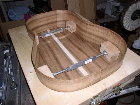

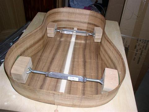

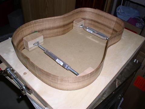

Here is the Black acacia Dread bent and put into a John Hall dread form.

Lance,
Great looking rim! A couple questions:
Is Acacia open or closed pore?
How easy is it to bend?
Thanks!
Jeff

JEff, the Acacia bent like butter! I thinned the sides to .085 and could hardly feel any resitance when bending the lower and upper bouts, ill have to give it a closer look to see about the pours, but i suspect there open.

[QUOTE=Jeff Doty] Lance,
Thanks!
Jeff[/QUOTE]
PostPosted: Thu Dec 30, 2004 4:16 am
Thanks!
Jeff[/QUOTE] Jeff I would rate it at a medium closed pore wood. you will need to fill the pores but they are nowhere as open as IRW. On Koa and Black acacia I cand fill a back and side set with two pbutt of Z-poxy
